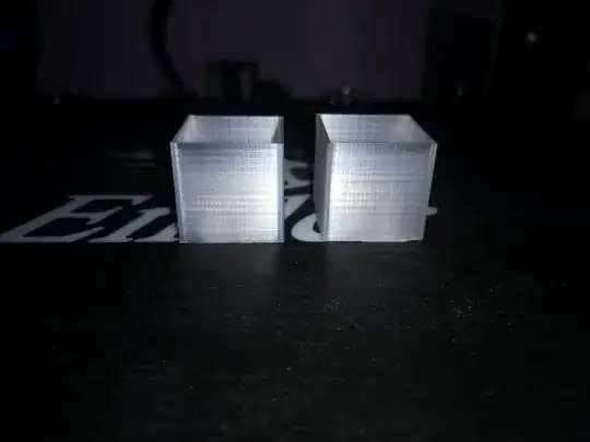

I did a quick test with a 20 mm cube and 0.2 mm layers (5 full steps, left) and 0.1975 mm layers (1 microstep short of 5 full steps, right) and there is no readily apparent difference:
test prints

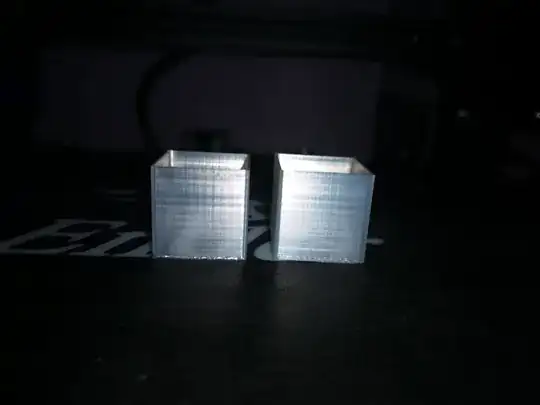

And repeated with single walls:
test prints
