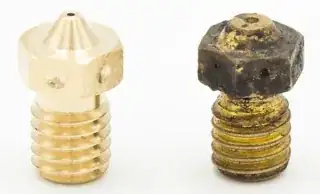

To replace a nozzle, there are probably a few reasons for doing so. A nozzle can wear out (see: How to identify nozzle wear; not only from the friction of standard filament, but especially when used with abrasive filament like glow-in-the-dark PLA, and glass or carbon fibre filled filament) causing the outer shape and the inner nozzle diameter to change size. This can result in lower quality prints or difficulty in getting the print to stick to the bed. Having a metal wire or drill bit of the diameter of the nozzle will tell you if the hole itself has worn out. Sometimes, a visual inspection may sometimes be enough for you to tell that it has worn out:
New (left) vs worn out (right) nozzle
(source: filament2print.com)
