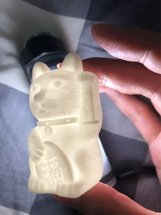

I bought Ender-5 and if I print sample model in bundle SD, it’s just perfect.
sample_cat

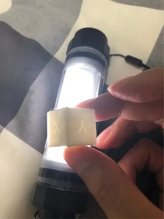

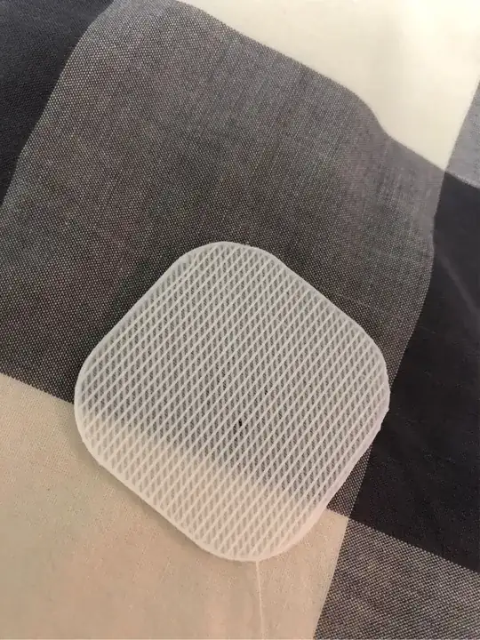

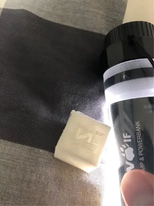

But when I tested basic cube with raft, its base and top is just ugly. Even thought its 4 sides are perfect.
raft bottom top side
  • Ultimaker Cura 4.2.1
  • Bed temperature 45 °C
  • Extruder temperature 200 °C
Which setting(s) should I check futher?

You may want to ensure that your filament diameter is correctly set in your printer's CURA profile, and that your hot end is at the correct temperature for the material you are using. Additionally, you should not need a raft to print the cube, and should be able to do without a raft or brim.
