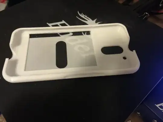

Here's my result, following this procedure:
Moto G4 case printed in white flex PLA
