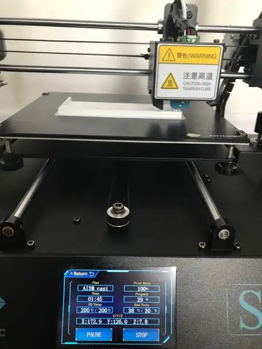

its up to you do some own test and see how its working for you:
  • yesterday decrease temp to 50* after some time no issue
  • today decrease temp to 30* some small disform but its keep printing ok
  • also you can add paper glue to bed
  • keep in mind that when temperature decrease bed is moving down due to lost heat
  • if is large print then its stay on bed, small print can detach when decrease temperature
