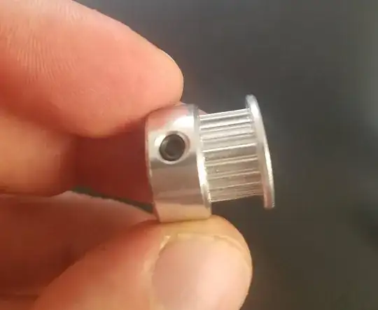

How should I describe this part which looks like a small gear so that I can research replacements?
image of a pulley
This came with my FLSUN 3D printer, which may be based on a Prusa design.

This is a timing belt pulley.
Specifically, is a GT2 timing pulley, 2 mm pitch (between teeth), 6 mm wide. The drive diameter is measured by the number of teeth (16 in this case) , the shaft diameter (bore) is measured in mm.
The 'GT2' part refers to the tooth profile, some other examples are shown half way down this page.
