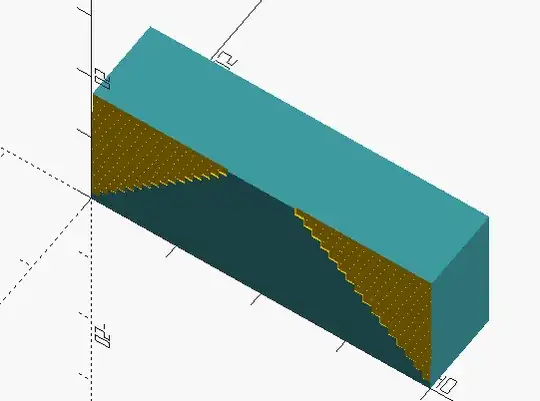

I put together a simple test part to test Y (or X) axis microstepping accuracy:
Test part design - OpenSCAD screenshot
Every 1mm in the Z direction, the face steps inward 1/80 mm (corresponding to my printer's [micro]steps per mm setting) in the Y direction and 1 mm in the X direction (to clearly show where the steps happen).

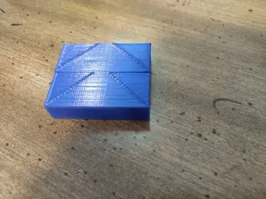

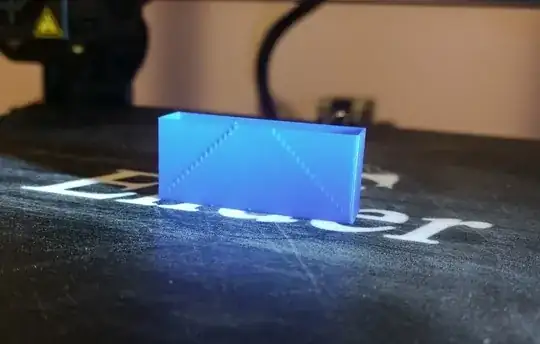

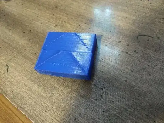

Photo of test prints lying down Photo of test prints upright
Several of the steps are missing entirely, and it's the middle vertical surface, rather than the side two stepped-vertical surfaces, that shows a step-like texture.

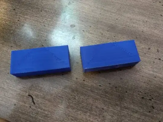

Update: With settings adjusted for 0 jerk and 50 mm/s² acceleration in the outer walls, I got a somewhat improved result:
New test print (lower) compared to old (upper)
All steps are clearly visible, but at the reduced and more varying speed, artifacts of the extruder motor accuracy (or maybe just bowden latency) are much worse, and at the steps the "overshoot and bounce back" effect is still happening. Is this consistent with a situation where the TL smoothers I asked about could benefit?

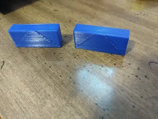

Update 2: I've further tested with leaving acceleration at default (500 mm/s²) and just disabling "jerk", i.e. "instantaneous" change in speed. The results are at least as good as the above with slow acceleration. What strikes me most is that the "overshoot then bounce back" happens outward from the model on both edges, rather than inward on the righthand side where the (CCW moving) nozzle is turning inward. Could this indicate that there's no microstepping accuracy problem at all, and that the artifact is purely from excess extrusion as the corner is turned?
Updated pic (new one below):
Old test piece above, new with default accel and 0 jerk below

The missing/inaccurate microsteps seem to be a bug/feature of Marlin:
// Moves (or segments) with fewer steps than this will be joined with the next move
#define MIN_STEPS_PER_SEGMENT 6
I'm not sure what the logic for this was in the stock firmware, which I originally performed the tests with, but with Marlin 2.0 I was completely missing the first 5 steps on the right (positive X) side. Changing the value to 1 mostly fixed the problem, but there was also a corresponding bug/feature in Cura:
            "meshfix_maximum_deviation":
                "label": "Maximum Deviation",
                "description": "The maximum deviation allowed when reducing the resolution for the Maximum Resolution setting. If you increase this, the print will be less accurate, but the g-code will be smaller. Maximum Deviation is a limit for Maximum Resolution, so if the two conflict the Maximum Deviation will always be held true.",
                "type": "float",
                "unit": "mm",
                "default_value": 0.05,
                "minimum_value": "0.001",
                "minimum_value_warning": "0.01",
                "maximum_value_warning": "0.3",
                "settable_per_mesh": true
The deviation should be set less than a single microstep, so 0.0125 mm.
With both of these fixed, I've got a perfect print:
successful print with each microstep visible
Sliced printing direction was counter-clockwise for all layers. The steps on the left side are where the slicer decided to put the layer seams (perhaps I should retry forcing it to put the seam somewhere else, or even using vase mode) so they have a little extra bulging from slight ooze during the Z move that you can clearly see from the lighting, but the steps on the right side are dimensionally near perfect.
I think I can safely say any past problems were the fault of firmware and slicing software, not anything physical/electrical/electronic.
