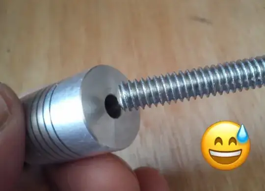

Well, you can use the screw with the size you can get easily, but sometimes can be messy at the time to mount to the printer, for example I'm using on two printers a standard thread 1/4 which measures 6.35 mm so is a little hard to coupling.
However milling the thread this can be mounted correctly, but the screw is soft and can be bent or warped easily making your printer wobbly and and produces failed prints.
However I´m satisfied with the printing quality and I can set prints with 0.1 and can increase 0.05 by 0.05
Now I want to mount an screw of 10 mm to minimize wobbling generated by those warped (bow) that repeats variation on size (x,y) on every cycle or every revolution. The 10mm screw are completely straight. I don't think that the stepper motors can be compromised with an extra weight.
So, Z layers can be at 0.05 mm but it can be achieved 0.02 mm tested until now. But wider diameter can achieve smooth edges.
