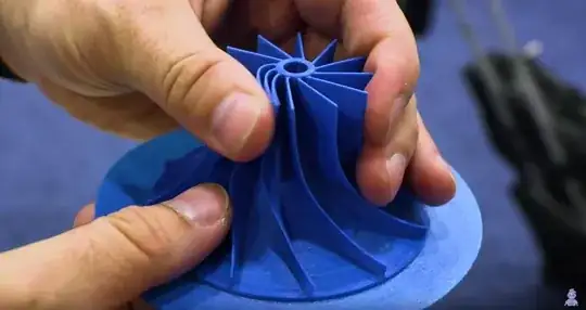

3D printing nerd showed a couple of filaments that fits this in his latest video "Printers at RAPID + TCT 2019":
Firstly a Nylon 6 high temperature filament:
Flexible 3D printed part - printed from high temperature nylon

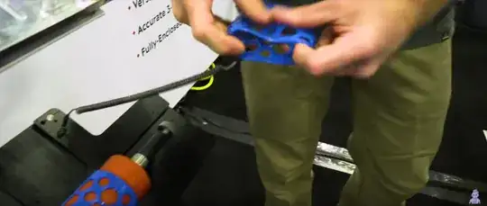

Another part of the video shows another flexible print, created on a four axis 3D printer, using TPU filament:
Flexible 3D printed part - printed from TPU
