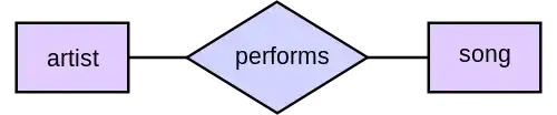

Entity-Relationship model
You have relationships (image source)
