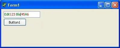

I was also interested to find out how deep the rabbit hole goes, so,
Here is a code sample using an interposer class (still needs to implement selection but the custom drawing works when the caret is in the control):

end;
