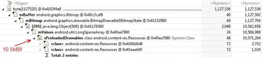

That looked a tad suspicous because my app doesn't deal with large images at all. In fact the total sum of the drawables in my app is about 250KB. So I created a heap dump and used MAT to locate where all this memory was going. byte[] arrays were by far the greatest consumer, so I drilled down and noticed the following:
I have absolutely no idea why sPreloadedDrawables is responsible for such a high retained heap size. I also have no idea of how to identify the root cause, or how to 'fix' it.
Where should I go from here? My app works mostly in the background via services which don't deal with image data at all. I do have Activities that the user may choose to use, but again, they use small drawables which don't explain such a large heap size. I also checked for any nasty occurrences of Activity leaks etc, but didn't locate any.
