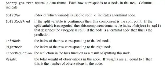

Now I can see the individual trees using pretty.gbm.tree as in
pretty.gbm.tree(gbm1,i.tree = 1)[1:7]
which yields
SplitVar SplitCodePred LeftNode RightNode MissingNode ErrorReduction Weight
0 2 1.5000000000 1 8 15 983.34315 1000

The manual page 18 shows the following:
Based on the manual, the first split occurs on the 3rd variable (zero based in this output) which is gbm1$var.names[3] "X3". The variable is ordered factor.
types<-lapply (lapply(data[,gbm1$var.names],class), function(i) ifelse (strsplit(i[1]," ")[1]=="ordered","ordered",i))
types[3]
So, the split is at 1.5 meaning the value 'd and c' levels[[3]][1:2.5] (also zero based) splits to left node and the others levels[[3]][3:4] go to the right.
Next, the rule continues with a split at gbm1$var.names[2] as denoted by SplitVar=1 in the row indexed 1.
Has anyone written anything to move through this data structure (for each tree), constructing rules such as:
"If X3 in ('d','c') and X2<1.0309565491 and X3 in ('d') then scoreTreeOne= -0.0102671518"
which is how I think the first rule from this tree reads.
