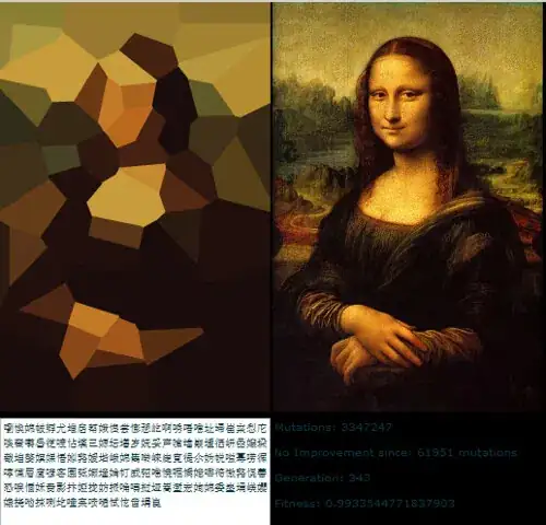

I came across this interesting post about trying to compress images into a Twitter comment, and lots of people in that thread (and a thread on Reddit) had suggestions about different ways you could do it. So, I figure it would make a good coding challenge; let people put their money where their mouth is, and show how their ideas about encoding can lead to more detail in the limited space that you have available.
I challenge you to come up with a general purpose system for encoding images into 140 character Twitter messages, and decoding them into an image again. You can use Unicode characters, so you get more than 8 bits per character. Even allowing for Unicode characters, however, you will need to compress images into a very small amount of space; this will certainly be a lossy compression, and so there will have to be subjective judgements about how good each result looks.
Here is the result that the original author, Quasimondo, got from his encoding (image is licensed under a Creative Commons Attribution-Noncommercial license):
Can you do better?
