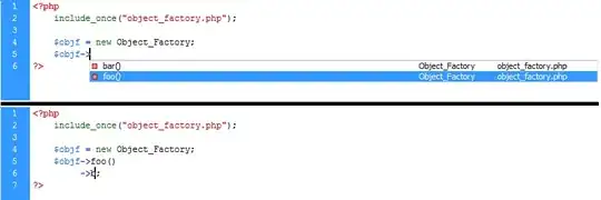

Issue #1 Chained methods do not display a code hint
Since PHP implemented the Classes and Objects, I've been able to chain my methods within classes/objects. Chaining is actually easy, by returning $this (the instance of that class), you can have a continuous chain of calls
class Object_Factory{
public function foo(){
echo "foo";
return $this;
public function bar(){
echo "bar";
return $this;
$objf = new Object_Factory;
//chaining
$objf->foo()
->bar();
Calling them separately shows the CH.
$objf->foo();
$objf->bar();
The problem is that after the first method has been called and I try to chain another method, there's no CH to display the next calls information.
So, here's my first question:
Is there a way, in Dreamweaver CS5, to make the code hints appear on chaining?
Plugins, some settings I haven't found, anything?
if("no") "Could you explain why?";
