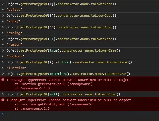

The best solution is toString (as stated above):
function getRealObjectType(obj: {}): string {
return Object.prototype.toString.call(obj).match(/\[\w+ (\w+)\]/)[1].toLowerCase();
FAIR WARNING: toString considers NaN a number so you must manually safeguard later with Number.isNaN(value).
The other solution suggested, using Object.getPrototypeOf fails with null and undefined
