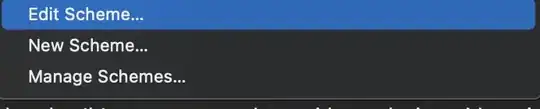

I tried the solution proposed by Serg Vasylchak but I got an error message (note just change letter symbols):
