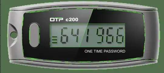

So say I have lots of images similar to these ones:

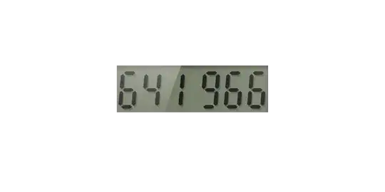

I am trying to get the rectangle with the numbers inside, its the one with the lighter background, also I would like to get rid of those lines but that isn't really as important, here is what it should look like:
I really just don't know how to go about solving this.
Here is the code I have, it recognizes the shapes and outlines them in green,
import numpy as np
import cv2
import sys
# read the image from arguments
image = cv2.imread('OCRimgs/test2.jpg')
# convert to grayscale
grayscale = cv2.cvtColor(image, cv2.COLOR_BGR2GRAY)
# perform edge detection
edges = cv2.Canny(grayscale, 30, 100)
# detect lines in the image using hough lines technique
lines = cv2.HoughLinesP(edges, 1, np.pi/180, 60, np.array([]), 50, 5)
# iterate over the output lines and draw them
for line in lines:
for x1, y1, x2, y2 in line:
cv2.line(image, (x1, y1), (x2, y2), color=(20, 220, 20), thickness=3)
# show the image
plt.imshow(image)
plt.show()
output:
if it helps I am making a OCR that takes in images like the ones you saw at the top and gets their images, this might seem pointless but trust me once I finish it, it will be super helpful to me.
