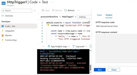

With all the below code and configuration, i am able to send data to events hub from a local functions app and published functions app, the issue which i am facing is when i run function from portal it takes forever to return response and then it gives 500 error, before adding this events hub code it was running fine on portal.
I am following guide from Microsof site but looks like it is not how it should send the message to events hub and i tried adding await to lines sending data, i have also tried commenting context.done(), and i also tried putting it in a function and calling it with await but still all gives me same behavior.
Same behavior i have seen with timer trigger function and it gives me following exception after running. It looks like it is sending the data but then after sometime it gives a timeout.
[Error] Executed 'Functions.myfunction' (Failed, Id=, Duration=131873ms)
