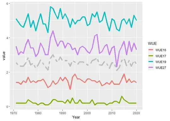

I managed to plot the means as a line, however, I do not know how to plot their respective standard deviation as geom_smooth.
When I just use the geom_smooth function, it does not seem to plot the correct standard deviation.
This is my code so far:
library("ggplot2")
df <- data.frame(wue_r$WUE19, wue_r$WUE27, wue_r$WUE16, wue_r$WUE17)
mean <- rowMeans(df)
wue_fin<-cbind(wue_r, means = mean)
colors <- c("WUE16"="chartreuse", "WUE19"="chartreuse3", "WUE27"="darkgreen", "WUE17"="darkolivegreen", "means"="black")
plot1 <- ggplot(wue_fin, aes(x=Year)) +
geom_line(aes(y=WUE16, color="WUE16"), linewidth=1.75) +
geom_line(aes(y=WUE19, color="WUE19"), linewidth=1.75) +
geom_line(aes(y=WUE27, color="WUE27"), linewidth=1.75) +
geom_line(aes(y=WUE17, color="WUE17"), linewidth=1.75) +
geom_smooth(aes(y=means, color="means"), span=0.2, fill="grey", linetype="twodash", linewidth=2) +
labs(color="Legend") +
scale_color_manual(values=colors)`
Thanks in advance!
