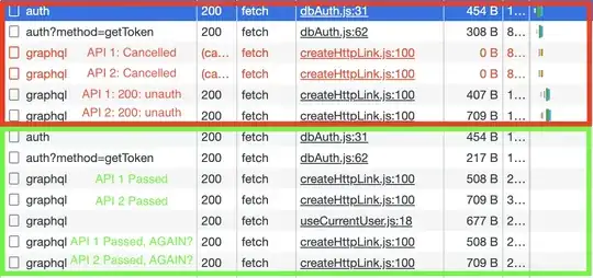

The Problem:
In the above usage, as you can see i am providing onLogin function prop to the useAuthenti custom hook. Because i want that function to run ON LOGIN and make the api calls in it.
However, the code isn't working as expected every time. sometimes it is working, other times it's not. (also weird.. seems like a race condition?)
When it's not working, I don't see any console logs (hinting the onLogin was never called), BUT, in networks tab I DO see calls being made by createHttpLink.js:100. it's failing also. During this case (when it doesn't work as expected), i see user login call succeeding BUT redwood js' getCurrentUser call isn't made. (you can ignore the redwoodjs part if you're unfamiliar with redwood js, just focus on the hook part) How are the apis that are inside onLogin running without any console logs surrounding it?
Networks Tab Debug
The red box shows attempt one at login (doesn't work) The green box shows attempt two at login (works)
