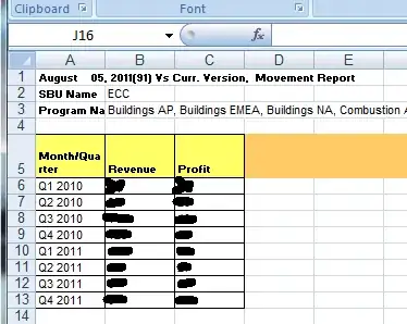

I have an excel spreadsheet that has a very simple page. It looks like so:
I use the following connection string to access this file:

Why would the code NOT read some cells? Note that there is the text "Profit" at C5. I can read B5 just fine as "Revenue". I can read C6 just fine as an integer value. But Profit seems to vanish.
This isn't such a big problem with the header information, but entire blocks of real data refuse to be read. Instead it returns DBNull, even when the cell contains real, valid, usable data. The cells are all formatted exactly the same between cells that can read and cells that return DBNull.
