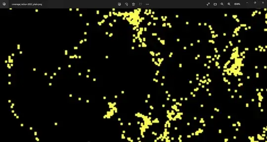

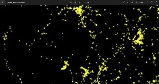

Good points
Bad points
The good version has uniformly coloured points/squares while the latter has strange points coloured irregularly.

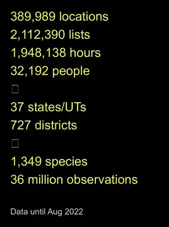

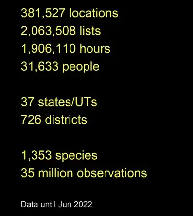

Good text
Bad text
The non-breaking space is formatted properly in the good version, while it appears as a box in the bad version.
