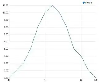

By default, the range of values of the X and Y-axis is derived from the minimum and maximum values of xdata and ydata, thus X is from 0 to 12 and Y is from 1 to 11. The rendered plot in plot.html looks like this:
How can I modify the code above to define a custom range for X and Y-axis for a given xdata & ydata? For instance, set Y from 0 to 12 and X from -1 to 13.
