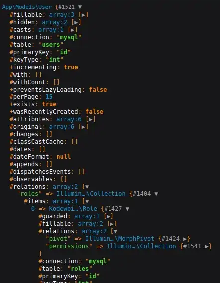

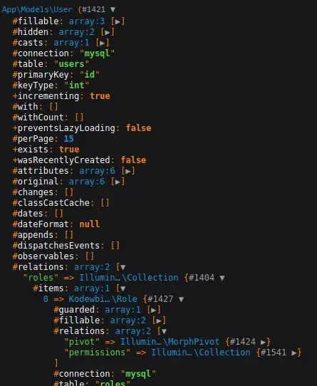

But in this way, I get the following results. Notice that both the original and the cloned instance are loading the relationships when I'm just trying to load the relationships in the cloned instance:
$original
$cloned
I was wondering if this is normal behavior. If it is a normal behavior, which I suppose it is not, I was wondering if there is any way to use the loadMissing method on a copy, replica or clone of an instance without modifying the original instance. Thank you very much in advance.
