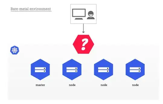

Hope you are all well,
I am currently trying to rollout the awx-operator on to a Kubernetes Cluster and I am running into a few issues with going to the service from outside of the cluster.
Currently I have the following services set up:
NAME TYPE CLUSTER-IP EXTERNAL-IP PORT(S) AGE
awx NodePort 10.102.30.6 <none> 8080:32155/TCP 110m
awx-operator NodePort 10.110.147.152 <none> 80:31867/TCP 125m
awx-operator-metrics ClusterIP 10.105.190.155 <none> 8383/TCP,8686/TCP 3h17m
awx-postgres ClusterIP None <none> 5432/TCP 3h16m
awx-service ClusterIP 10.102.86.14 <none> 80/TCP 121m
kubernetes ClusterIP 10.96.0.1 <none> 443/TCP 17h
I did set up a NodePort which is called awx-operator. I did attempt to create an ingress to the application. You can see that below:

Now I am not too sure whether the default-http-backend:80 error is a red-herring as I have seen this in a number of places and they don't seem too worried about it, but please correct me if I am wrong.
Please let me know whether there is anything else I can do to troubleshoot this, and I will get back to you as soon as I can.
