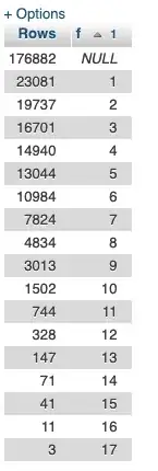

This won't be the exact solution for this question, but it is just similar suggestion for someone other. I need to create the number buckets too, because if I groupped by number i got 9k different values.
I need to have smaller count of groups.
I managed it by grouping by logarithm (and round it). Now instead of 9k groups i have only 18 groups. (Then i will use it for PDF or CDF for 1-x scale score computation).
SELECT COUNT(*) AS `Rows`, round(log(`diff`)) f FROM `users` GROUP BY f ORDER BY f
