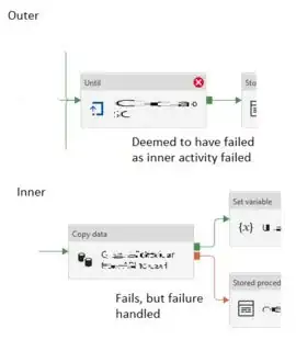

Solution
Put the error-handling steps in their own pipeline and run them from an ExecutePipeline activity. You'll need to pass-in all the parameters required from the outer pipeline.
You can then use the completion (blue) dependency from the ExecutePipeline (rather than success (green)) so the outer pipeline continues to run despite the inner error.
Note that if you want the outer to know what happened in the inner then there is currently no way to pass data out of the ExecutePipeline to its parent (https://feedback.azure.com/forums/270578-data-factory/suggestions/38690032-add-ability-to-customize-output-fields-from-execut).
To solve this, use an sp activity inside the ExecutePipeline to write data to a SQL table, identified with the pipeline run id. This can be referenced inside the pipeline with @pipeline().RunId.
Then outside the pipeline you can do a lookup in the SQL table, using the run ID to get the right row.
