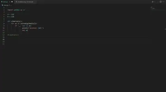

You can write your own clearvars function.
test.py
import pandas as pd
A = 123
B = 224
def clearvars():
for el in sorted(globals()):
if '__' not in el:
print(f'deleted: {el}')
del el
clearvars()
python test.py
deleted: A
deleted: B
deleted: clearvars
deleted: pd
You can delete the print statement within the function if you want.
