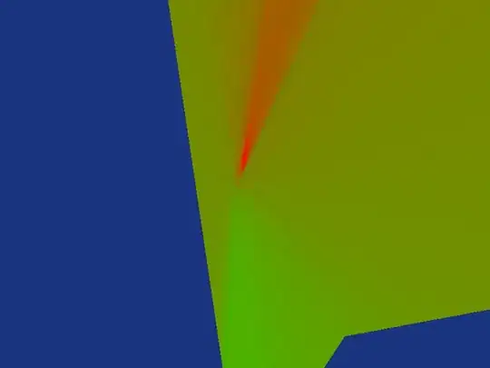

All this gives me is an obviously incorrect result:
So my question is this: Is my understanding of how to calculate the final bone transformations wrong? If so, what is the correct way of doing it?
