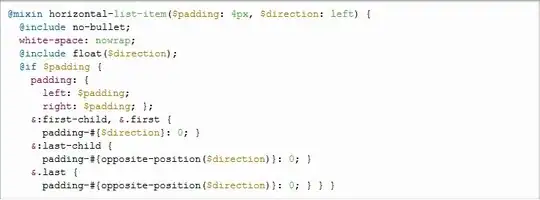

I have created an animation for you to consider the difference:
Also, didn't you hate it every time when your code failed to work/compile due to a semicolon missing (and maybe the interpreter/compiler producing a misleading error message)?
Basically, the indented .sass syntax just removes bloats of visual noise.
Of course, it requires some time to get used to it. At first it looks alien to anyone who has some experience with CSS or LESS. But once you get accustomized a bit, you'll find yourself feeling distaste to the bracketed syntax of CSS/LESS/SCSS and JavaScript and preferring the clean syntax of SASS, HAML, CoffeeScript and Python/Ruby.
