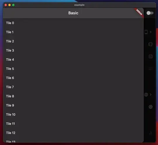

You could try this widget to test your widgets changing screen size in realtime
Screen Size Test
https://pub.dev/packages/screen_size_test
Preview
Demo https://dartpad.dartlang.org/43d9c47a8bf031ce3ef2f6314c9dbd52
Code Sample
import 'package:screen_size_test/screen_size_test.dart';
MaterialApp(
title: 'Demo',
builder: (context, child) => ScreenSizeTest(
child: child,
home: Scaffold(
body: ListView(
children: List.generate(
20,
(index) => Container(
padding: EdgeInsets.all(10),
child: Placeholder(),
