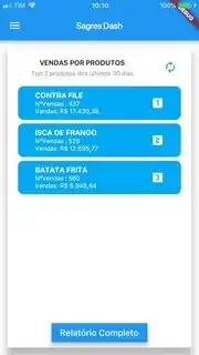

I have this screen:
With this code:
return new Container(
height: height,
padding: new EdgeInsets.all(10.0),
child: new Card(
elevation: 10.0,
child:
new Column(
mainAxisSize: MainAxisSize.max,
children: <Widget>[
new ListTile(
trailing:
_buildCounterButton(),
title: new Center(child: new Text('VENDAS POR PRODUTOS', style: new TextStyle(fontWeight: FontWeight.bold))),
subtitle: new Center(child: new Padding(padding: new EdgeInsets.only(top: 5.0), child:
new Text('Top 3 produtos dos últimos 30 dias', textAlign: TextAlign.center,))),
new FutureBuilder<List<RelatorioProdutos>>(
future: fetchRelatorioPorProduto(new http.Client(),'$dateInicial', '$dateFinal'),
builder: (context, snapshot) {
if (snapshot.hasError) print(snapshot.error);
else
auxTelaDetalhada = RelatorioVendasTotalizadasProdutos(prods: snapshot.data, aondeVoltar: 0,);
return snapshot.hasData
? new porProdutoList(listas: snapshot.data)
: new Center(child: new RefreshProgressIndicator());
new Expanded(
child: new Align(
alignment: Alignment.bottomCenter,
child: new Padding(padding: new EdgeInsets.only(bottom: 10.0),
child: new RaisedButton(
child: new Text("Relatório Completo",
style: new TextStyle(color: Colors.white, fontSize: 20.0),),
color: Colors.blue,
elevation: 8.0,
splashColor: Colors.lightBlue,
onPressed: () {
Navigator.pushReplacement(
context,
new MaterialPageRoute(
builder: (context) => auxTelaDetalhada),
I want to have this screen in the end of process.

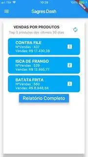

So i was tring to put this RaisedButton in the other method return, with this the button appear only on the end of json request. But, i cant align this button when i put it inside the other method.

Im tring to do this:
Widget test =
new Column(children: <Widget>[
new Column(
children: <Widget>[
listaTiles[0],
listaTiles[1],
listaTiles[2]]),
new Align(
color: Colors.blue,
elevation: 8.0,
onPressed: () {
context,
But i get this:
Anyone have any idea to get this working?
