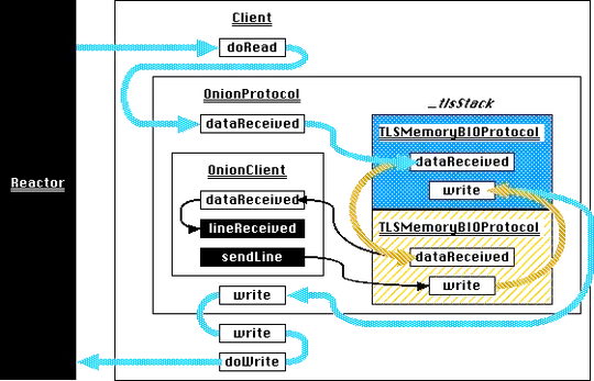

Here's the flow of data after the first call to startTLS:
As expected, new data delivered to OnionProtocol.dataReceived is routed to the TLSMemoryBIOProtocol stored on the _tlsStack, which passes the decrypted plaintext to OnionClient.dataReceived. OnionClient.sendLine also passes its data to TLSMemoryBIOProtocol.write, which encrypts it and sends the resulting ciphertext to OnionProtocol.write and then Client.write.
