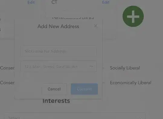

I am using Element's Notification component but when it is activated the dialog appears but seems to be "behind" the grey background that is also introduced. Clicking anywhere removes the grey background and allows the interaction with the dialog box but without the greyed out background that should be filtering out the noise of the normal screen. Here is a short video that shows the various states:
The code to put the component in as follows:

I have used the inspector to poke around at the CSS but I haven't yet understood what's causing this from a CSS perspective nor a Vue/Element perspective. Any help would be appreciated.
I have further analyzed the HTML/CSS and the component appears to introduce two separate blocks in the DOM:
The lower block is the grey background which you'd expect to "blur" the page and focus attention on the modal. It, however, is in front of the dialog. Also of interest is that clicking anywhere seems to target the grey background and dismiss it but in so doing it also has a subtle effect on the placement on the dialog box as can be seen here:
Note that the z-index of the dialog box is greater than the background which intuitively makes sense to me but I'd have thought this would have put the dialog box on top. Guess that's not all there is to this.
I have hacked a work-around for now by changing the background to display: none and then adding the following HTML directly before the modal dialog in the DOM:
<div class="modal-background" v-if="showAddDialog"></div>
These seems to validate my underlying suspicion that placement within the DOM tree is important and the component's attempt to place the modal background at the very end of the DOM is somehow problematic.
