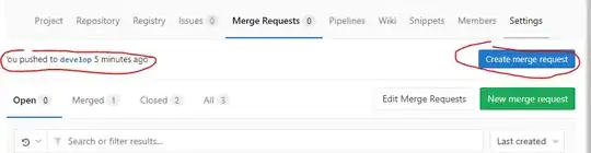

I have pushed a commit by mistake to my Gitlab. How can I undo it?

Assuming that you mistakenly created a merge request on Gitlab, All you have to do is scroll to the bottom of the merge request page and click on the button close merge request
