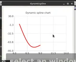

I would like to automatically change the y-axis by using a dynamic plot. I changed the dynamic plot example in the examples and have appended lots of points. After a new point is appended, the plot should adjust its y-axis to account for the new maximum value. Is it possible for the plot to do this automatically?

I attached an image about it. – Gokhan Sahin Jul 06 '17 at 05:11
You could show the code with which the graph generates. – eyllanesc Jul 06 '17 at 05:12
1This is the example ?: https://doc.qt.io/qt-5/qtcharts-dynamicspline-example.html – eyllanesc Jul 06 '17 at 05:13
Yes, I changed only the amplitude that its function. m_y = 50*(qrand() % 5 - 2.5); – Gokhan Sahin Jul 06 '17 at 05:15
