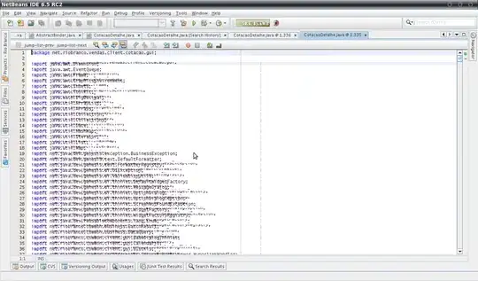

So as you can see by the console logs, it will say each step, first it will show the array its looking in, then the object its looking for. heres a screenshot of it in action:
So you can see the array contains 1 array which contains 1 object. An object with the properties x: 3, y: 2
Then you can see the object its searching for, an object with the exact same properties
Would anyone know why its sometimes not finding it? and sometimes it does?
