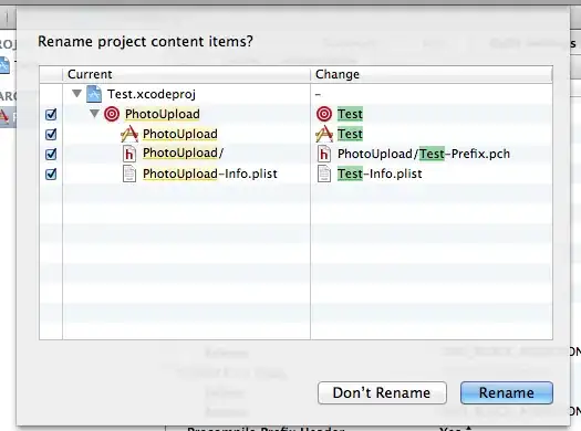

It's simple. Just press enter on name of project. Rename your project as desired. This will prompt changes to be done in entire Project. Click on Rename.

If you want to change Project Name, Target name, -Info.plist name & -Prefix.pch name then,
- Select Project in Xcode (.xcodeproj file)
- Selecte file inspector
- In identity section change project name which u want to update & press enter
- After scanning whole project it will ask to change the file names i.e target, plist & pch file
- Select check boxes as per your need
