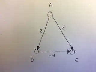

For example:
The claim here is that (A,C) will be set to 1 and never updated to the correct distance -2.
But the pseudocode from CLRS says that we first put C and B on the Heap with distances 1 and 2 respectively; then we pop C, see no outgoing edges; then we pop B, look at the edge (B,C), see that Dist[C] > Dist[B] + w(B,C), update Dist[C] to -2, put C back on the heap, see no outgoing edges and we're done.
So it worked fine.
