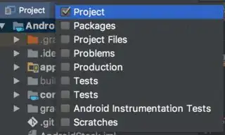

To see the actual file structure of the project including all files hidden from the Android view, select Project from the dropdown at the top of the Project window
So, click that <> looking button to the right of that and select Project.
You are showing Project Files
Here's the options I see in IntelliJ.
So, no, not wrong. My projects also look like that in the Project Files view.
