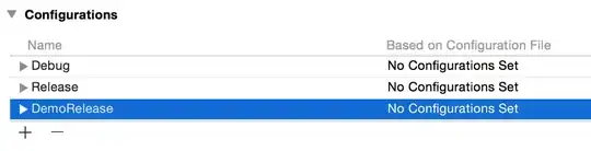

I am hosting my Parse Server Heroku. The setup was very smooth and everything is working fine with me now. I have Parse Cloud Code that I need to setup I found a way to do it from this answer from StackOverFlow. I have uploaded the cloud code to my parse server github repository you check the screenshot. But when I deploy this repository to Heroku I get Application Error. When I deploy the normal version of Parse Server its works fine.
