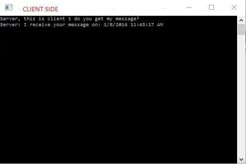

And suppose you want to reply your sender after you receive the message, simply do this in the if (received > 0) part:
if (received > 0) {
byte[] data = new byte[received]; //the data is in the byte[] format, not string!
//DO SOMETHING ON THE DATA int byte[]!! Yihaa!!
Console.WriteLine(Encoding.UTF8.GetString(data)); //Here I just print it, but you need to do something else
//Message retrieval part
//Suppose you only want to declare that you receive data from a client to that client
string msg = "I receive your message on: " + DateTime.Now;
socket.Send(Encoding.ASCII.GetBytes(msg)); //Note that you actually send data in byte[]
Console.WriteLine("I sent this message to the client: " + msg);
receiveAttempt = 0; //reset receive attempt
socket.BeginReceive(buffer, 0, buffer.Length, SocketFlags.None, new AsyncCallback(receiveCallback), socket); //repeat beginReceive
And after putting a little more things in your main routine, you are done(!) - IF you do not ask for sending to client as byte[]

Naturally, you need to define your receiveCallback, just like what you did for the server. And yes, it is as you have guessed, it is almost identical to what you did for the server!
You can do anything you want with your data. Note that the data you receive is actually in byte[], not string. So you can do anything with it. But for example's sake, I will just use string to display.
const int MAX_RECEIVE_ATTEMPT = 10;
static int receiveAttempt = 0;
private static void receiveCallback(IAsyncResult result) {
System.Net.Sockets.Socket socket = null;
try {
socket = (System.Net.Sockets.Socket)result.AsyncState;
if (socket.Connected) {
int received = socket.EndReceive(result);
if (received > 0) {
receiveAttempt = 0;
Buffer.BlockCopy(buffer, 0, data, 0, data.Length); //copy the data from your buffer
//DO ANYTHING THAT YOU WANT WITH data, IT IS THE RECEIVED PACKET!
//Notice that your data is not string! It is actually byte[]
//For now I will just print it out
Console.WriteLine("Server: " + Encoding.UTF8.GetString(data));
} else if (receiveAttempt < MAX_RECEIVE_ATTEMPT) { //not exceeding the max attempt, try again
++receiveAttempt;
} else { //completely fails!
Console.WriteLine("receiveCallback is failed!");
receiveAttempt = 0;
clientSocket.Close();
} catch (Exception e) { // this exception will happen when "this" is be disposed...

Here you go! I tested it by sending string for display, but I already put up what is needed when you want to change it to byte[]
Code for your test:

Last Remarks (Edit)
Since the code above is run using Console Application it must be run with static main void keyword. And thus client Socket defined above is of static type. This may prevent the client Socket to be defined multiple times as each time it is "defined", since it is of the same class named Program, it will refer to the same Socket (though this may not always the case, at least according to the OP's experiment: he can run multiple clients successfully in the same computer).
Nevertheless, to overcome this is not that hard. Simply port the client application to the platform which is non-initiated as static class (such as WinForms) and all the above code would still run as per normal. Alternatively, if it must be run using the Console Applications, and the problem occurs, simply copy the client application and re-define it using different namespace or different class name to avoid defining identical Socket due to identical namespace or class.
But the most important part on this problem solving is the use of Async and Sync wisely to solve the given issue.
