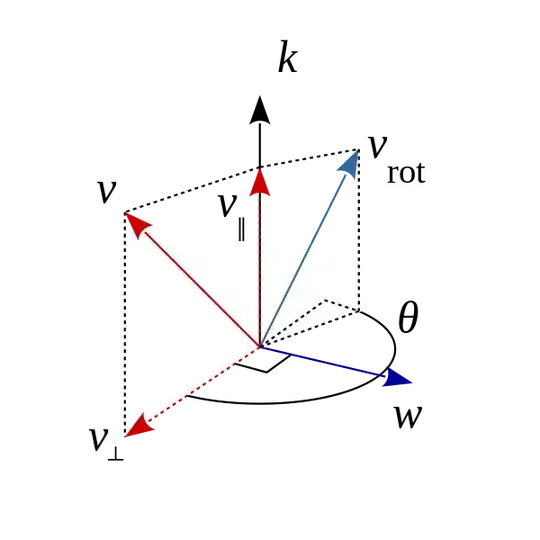

Here's a pictorial example I got from Wikipedia:
Source: Rodrigues' Rotation formula
The vector k in our case is pointing straight up and the vector v is pointing on a 45 degree angle northwest. We wish to rotate this vector by an angle of 180 degrees around the axis defined by the vector k, and so if you do this, vrot is the resulting vector. v|| and v_|_ are the parallel and perpendicular projections of v with respect to the vector k. These are shown to derive the Rodrigues formula, which I won't go through here. I'll refer you to the article if you want a full derivation.
