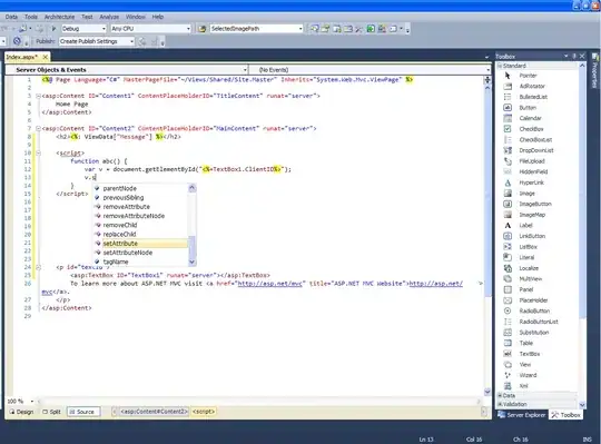

That's where I begin to have issues. If I have to branch both the front-end and API, I cannot get TeamCity to do what I want in this regard. My question is this: how do I tell Team City to run a UA build using branch "A" from the Front-End CI build config and branch "B" from the API CI build config, where "A" and "B" can be any arbitrary branch? Currently right now, all branches from both snapshots are shown when I look at the UA build config. Here's a good picture:
If I run api-branch, it will always use the default branch from the Front-end CI snapshot. Same for any branch on the front-end snapshot. I cannot seem to find a way to specify this in the configuration or when starting a build.
