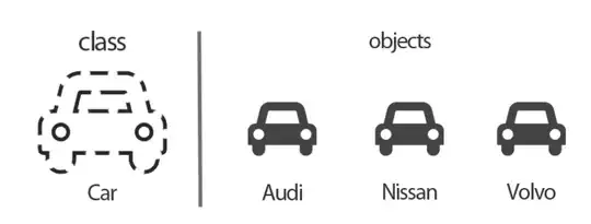

If Car is a class, 3 Cars are 3 different objects. All of these objects are instances. So these 3 cars are objects from instances of the Car class.
But the word "instance" can mean "structure instance" also. But object is only for classes.
All of the objects are instances. Not all of the instances must be objects. Instances may be "structure instances" or "objects". I hope this makes the difference clear to you.

Java is an object-oriented programming language (OOP). This means, that everything in Java, except of the primitive types is an object.
Now, Java objects are similar to real-world objects. For example we can create a car object in Java, which will have properties like current speed and color; and behavior like: accelerate and park.
That's Object.
Instance, on the other side, is a uniquely initialized copy of that object that looks like Car car = new Car().
Check it out to learn more about Java classes and object
