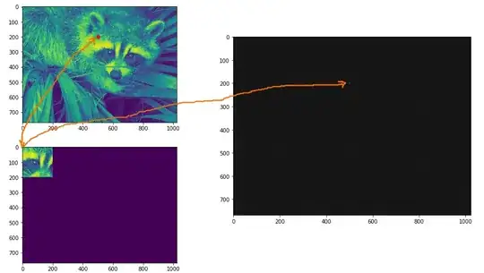

Here is an example: We take two similar images, but of different phases and plot the phase correlation (a black image with a single white dot at the appropriate phase difference).
from scipy import misc
from matplotlib import pyplot
import numpy as np
#Get two images with snippet at different locations
im1 = np.mean(misc.face(), axis=-1) #naive colour flattening
im2 = np.zeros_like(im1)
im2[:200,:200] = im1[200:400, 500:700]
corrimg = phase_correlation(im1, im2)
r,c = np.unravel_index(corrimg.argmax(), corrimg.shape)
pyplot.imshow(im1)
pyplot.plot([c],[r],'ro')
pyplot.show()
pyplot.imshow(im2)
pyplot.show()
pyplot.figure(figsize=[8,8])
pyplot.imshow(corrimg, cmap='gray')
pyplot.show()
