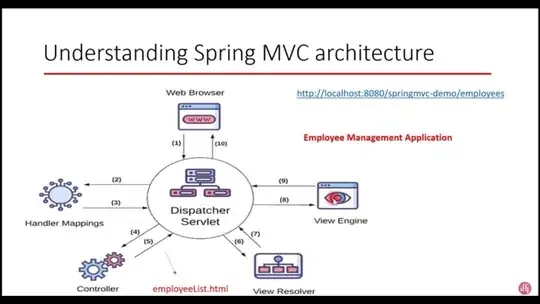

In this image (which I got from here), HTTP request sends something to Dispatcher Servlet.
My Question is what does Dispatcher Servlet do?
Is it something like getting the information thrown from the web page and throwing it to the controller?

In Spring MVC, all incoming requests go through a single servlet. This servlet - DispatcherServlet - is the front controller. Front controller is a typical design pattern in the web applications development. In this case, a single servlet receives all requests and transfers them to all other components of the application.
The task of the DispatcherServlet is to send request to the specific Spring MVC controller.
Usually we have a lot of controllers and DispatcherServlet refers to one of the following mappers in order to determine the target controller:
BeanNameUrlHandlerMapping;ControllerBeanNameHandlerMapping;ControllerClassNameHandlerMapping;DefaultAnnotationHandlerMapping;SimpleUrlHandlerMapping.If no configuration is performed, the DispatcherServlet uses BeanNameUrlHandlerMapping and DefaultAnnotationHandlerMapping by default.
When the target controller is identified, the DispatcherServlet sends request to it. The controller performs some work according to the request
(or delegate it to the other objects), and returns back to the DispatcherServlet with the Model and the name of the View.
The name of the View is only a logical name. This logical name is then used to search for the actual View (to avoid coupling with the controller and specific View). Then DispatcherServlet refers to the ViewResolver and maps the logical name of the View to the specific implementation of the View.
Some possible Implementations of the ViewResolver are:
BeanNameViewResolver;ContentNegotiatingViewResolver;FreeMarkerViewResolver;InternalResourceViewResolver;JasperReportsViewResolver;ResourceBundleViewResolver;TilesViewResolver;UrlBasedViewResolver;VelocityLayoutViewResolver;VelocityViewResolver;XmlViewResolver;XsltViewResolver.When the DispatcherServlet determines the view that will display the results it will be rendered as the response.
Finally, the DispatcherServlet returns the Response object back to the client.

DispatcherServlet is Spring MVC's implementation of the front controller pattern.
See description in the Spring docs here.
Essentially, it's a servlet that takes the incoming request, and delegates processing of that request to one of a number of handlers, the mapping of which is specific in the DispatcherServlet configuration.
We can say like DispatcherServlet taking care of everything in Spring MVC.

So, in generally DispatcherServlet capture request URI and hand over to HandlerMapping. HandlerMapping search mapping bean with method of controller, where controller returning logical name(view). Then this logical name is send to DispatcherServlet by HandlerMapping. Then DispatcherServlet tell ViewResolver to give full location of view by appending prefix and suffix, then DispatcherServlet give view to the client.
You can say Dispatcher Servlet acts as an entry and exit point for any request. Whenever a request comes it first goes to the Dispatcher Servlet(DS) where the DS then tries to identify its handler method ( the methods you define in the controller to handle the requests ), once the handler mapper (The DS asks the handler mapper) returns the controller the dispatcher servlet knows the controller which can handle this request and can now go to this controller to further complete the processing of the request. Now the controller can respond with an appropriate response and then the DS goes to the view resolver to identify where the view is located and once the view resolver tells the DS it then grabs that view and returns it back to you as the final response. I am adding an image which I took from YouTube from the channel Java Guides.
Dispatcher Controller are displayed in the figure all the incoming request is in intercepted by the dispatcher servlet that works as front controller. The dispatcher servlet gets an entry to handler mapping from the XML file and forwords the request to the Controller.
