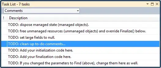

If you are referring to TODOs that are defined with the // TODO comments, open the Task List and set it to the Comments filter.

10Also, if your TODOs use a different string than `TODO`, you can make those show upin the task list as well by going to `Tools->Options->Task List` and adding items to the "Token list:" there (along with priority). – Noah Richards Jan 29 '10 at 21:26

@Zyphrax Image broken! – Joel Peltonen Sep 09 '14 at 11:21
1@Nenotlep thanks for letting me know. I've replaced it. – Yvo Sep 11 '14 at 04:47

ReSharper has a nice ToDo explorer to get an overview of all todos -or custom keywords- comments.

This is nicer than the built in ux for larger projects. By default, the TODO items are organized in the same way as the solution. The default view is just ordered alphabetically by file name containing the comment. – Kijana Woodard Jun 27 '14 at 03:39
I didn't realize resharper has this after using it all these years. I like this option as it organizes better. – ScottG Oct 22 '14 at 17:11
Note that in Express versions like Visual Web Developer 2010 Express and Visual C# Express 2010, you need to be in Expert mode to enable the task list. Expert mode is at menu Tools → Settings → Expert Mode.
Then the option to open the list is in menu View → Task List.
