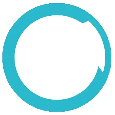

UPDATE: I migrated the code over to CAShapeLayer instead, but now I'm facing a different issue. It's best described with this image:
What's happening is that when the layer is supposed to shrink, the thin outer line is still there (regardless of direction of movement). And when the bar shrinks, the delta of 1-xisn't removed unless I explicitly make a new white shape over it. The code for this follows. Any ideas?

UPDATE 2: I've ironed out most of the other bugs. Turned out it was just me being rather silly the whole time and overcomplicating the whole animation (not to mention multiplying by 1 everywhere, what?). I've made a gif of the bug I can't solve:
Any ideas?
UPDATE 3: (and closure). I managed to get rid of the bug by calling
[self.layer.sublayers makeObjectsPerformSelector:@selector(removeFromSuperlayer)];
And now everything works as it should. Thanks for all the help!
